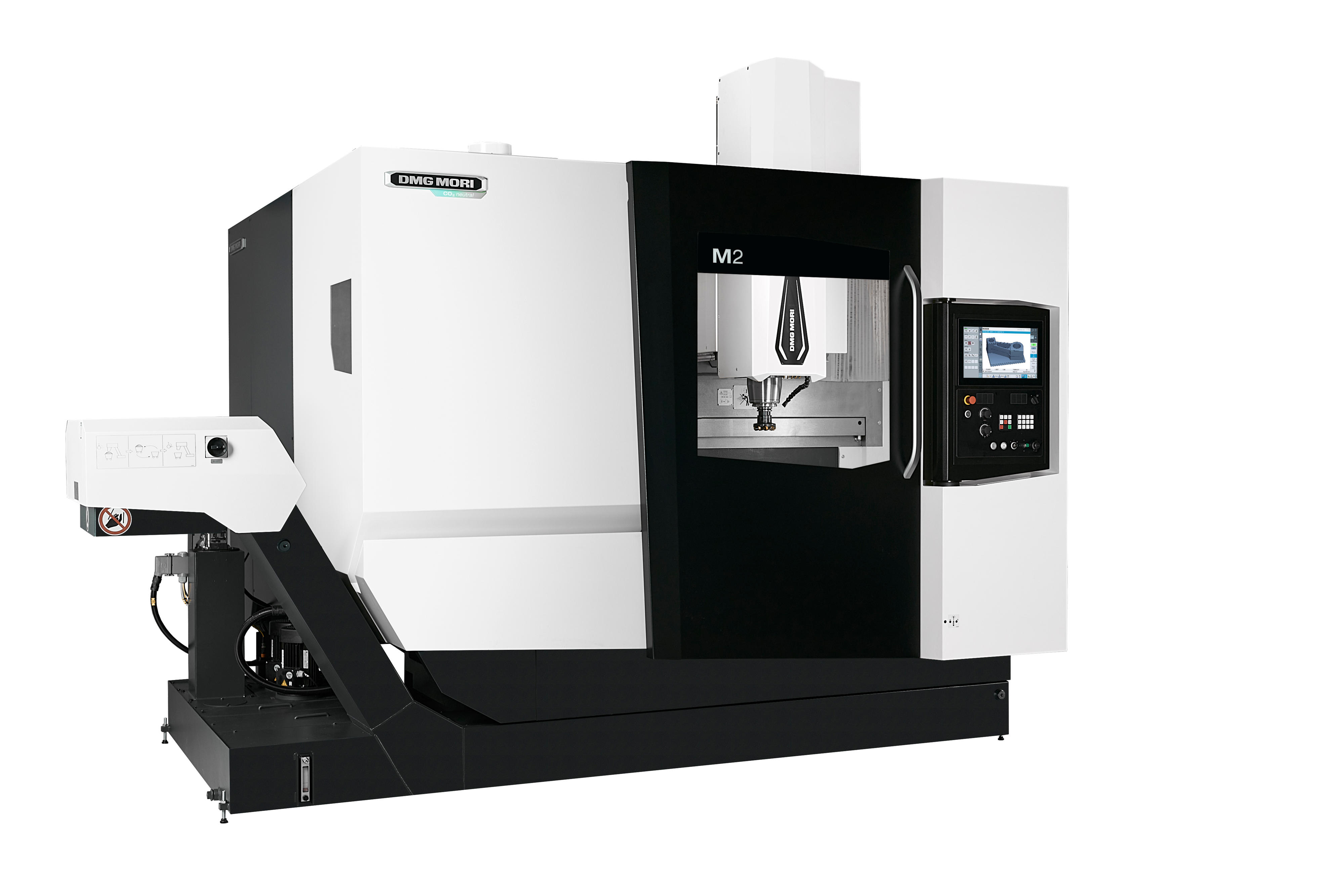

M2
Long lasting production with DMG MORI quality
Max. X-axis stroke
1,100 mm
Max. Y-axis stroke
550 mm
Max. Z-axis stroke
510 mm
Max. workpiece height
400 mm
Max. workpiece weight
1,700 kg
Max. workpiece length
1,100 mm
Max. workpiece width
550 mm

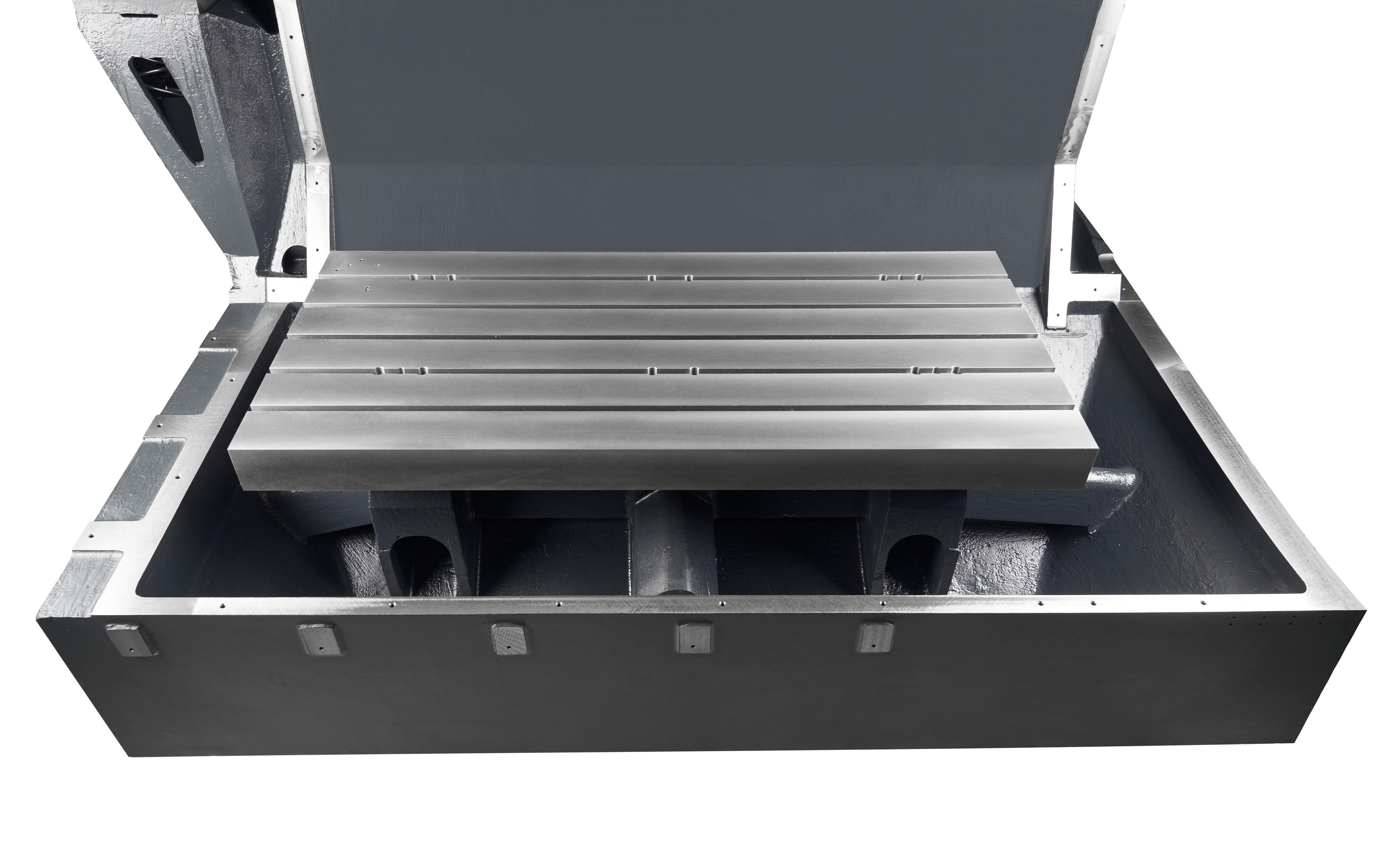

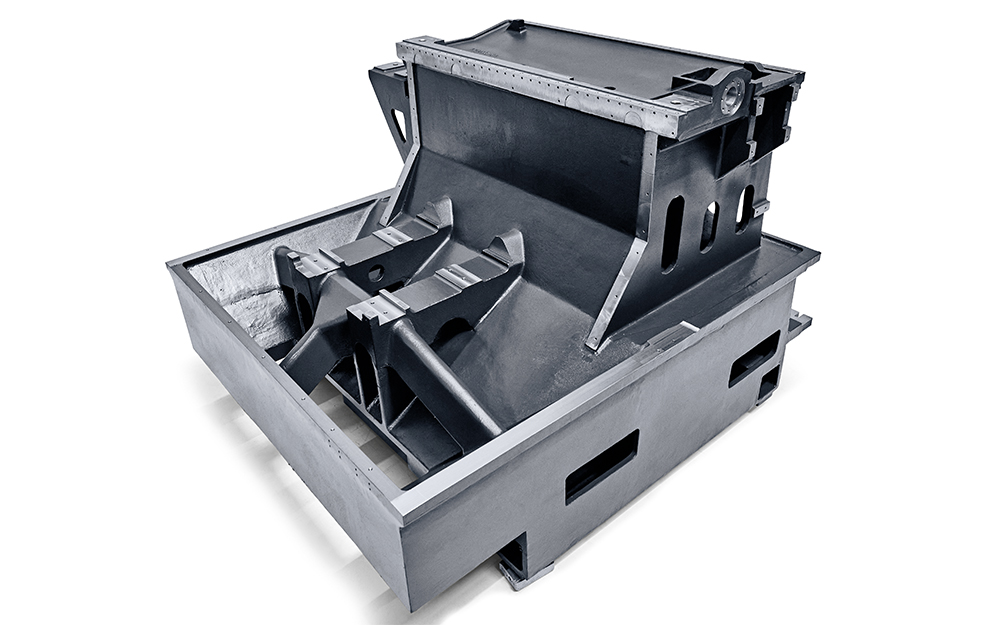

Unique design based on monolithic machine bed
  • Great static and dynamic rigidity
  • Perfect damping properties for best surface quality
  • Best performance with cutting depth up to 3,5 mm with milling head D63 mm
Fixed machine table
  • Constant dynamic characteristic regardless  you make a part of 10 kg either 1.700 kg
  • Huge table surface 1.400 x 600 mm with 5 t-slots for maximum flexibility
  • Great rigidity with max. workpiece weight up to 1.700 kg - best in its class!

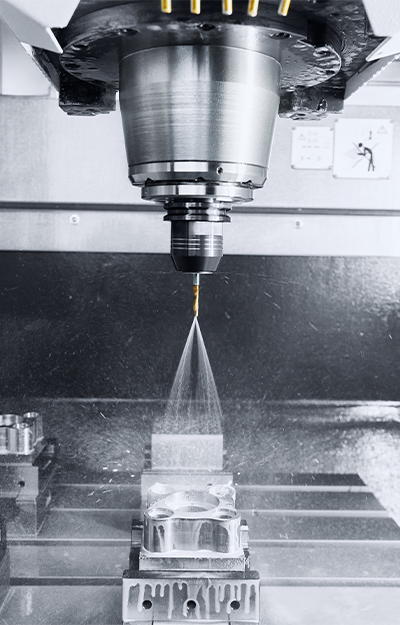

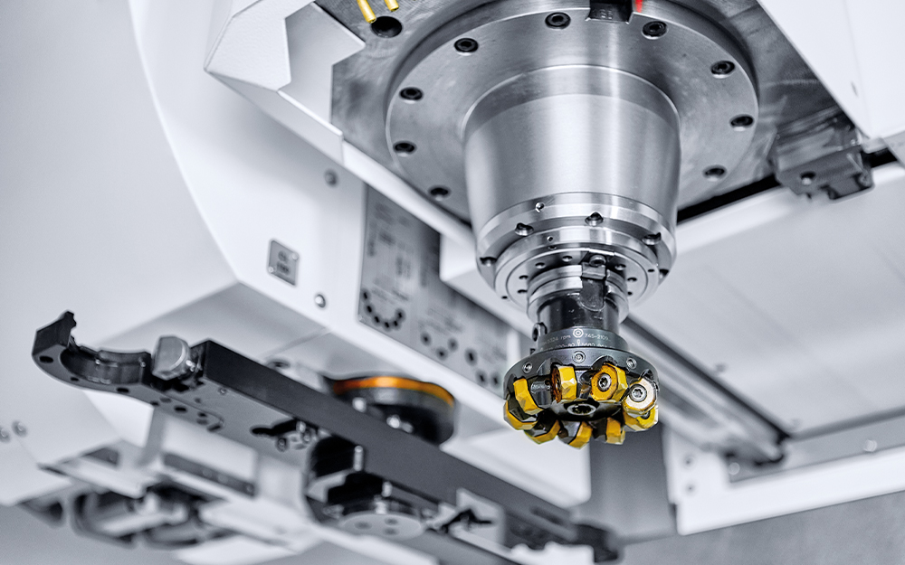

Proven inline 10.000 eiter 12.000 rpm spindle
  • Over 4.000 units installed worldwide
  • up to 12.000 rpm with torque 83 Nm and power 13 kW and internal coolant supply 20 bar
  • Hydraulic tool release mechanism for even higher reliability
Highest rigidity in its class
Best performance & surface quality

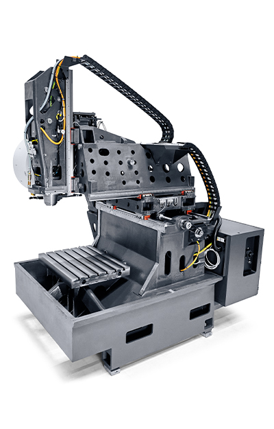

  1. Monolithic machine bed
  2. Massive castings & total machine weight nearly 7.000 kg
  3. Wide distance between the guideways in all axes (X = 630mm / Y = 515mm / Z = 270mm)
  4. Roller guideways in all axes

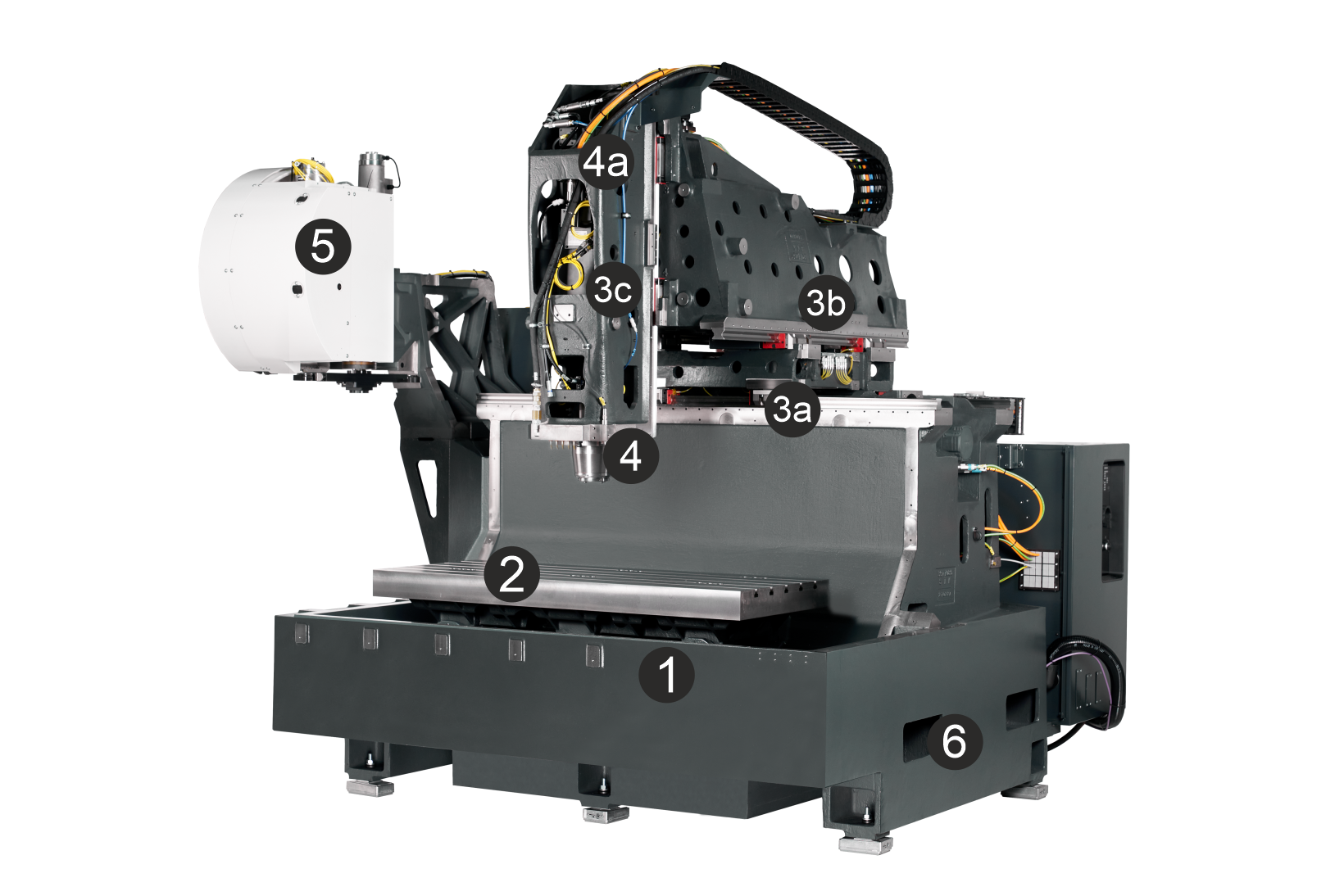

Design based on monolithic bed
  1. Massive and thermally stable monolithic machine bed with weight of 3.400 kg!
  2. Fixed machine table with T-slots: 1 x 14H7 and 4 x 14H12
  3. Large distance between guideways:
    3a. 630 mm in X-axis with travel 550 mm
    3b. 515 mm in Y-axis with travel 550 mm
    3c. 270 mm in Z-axis with travel 510 mm
  4. Inline spindle 10,000 or 12,000 rpm:
    4a. Internal coolant supply & 20 bar pump (optional)

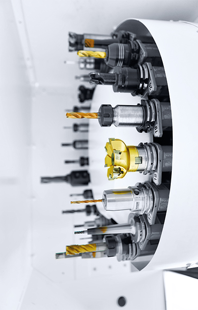

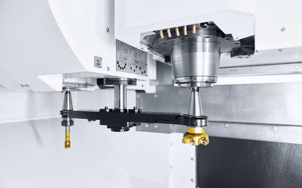

  5. 24-pocket tool magazine with double gripper
  6. Easy levelling on 3 feet + 2 additional supporting feet for higher dynamic rigidity
  • Perfect machining performance and high surface quality thanks to superior stiffness!
  • Large heat capacity of components guarantee thermal stability!
  • Proven quality of the DMG MORI inline spindle – more than 4,000 units installed worldwide!
  • Perfectly suited working area combined with compact footprint of only 7.3 m2
  • Fixed & rigid table with max. load of up to 1,700 kg assures high machining performance!
