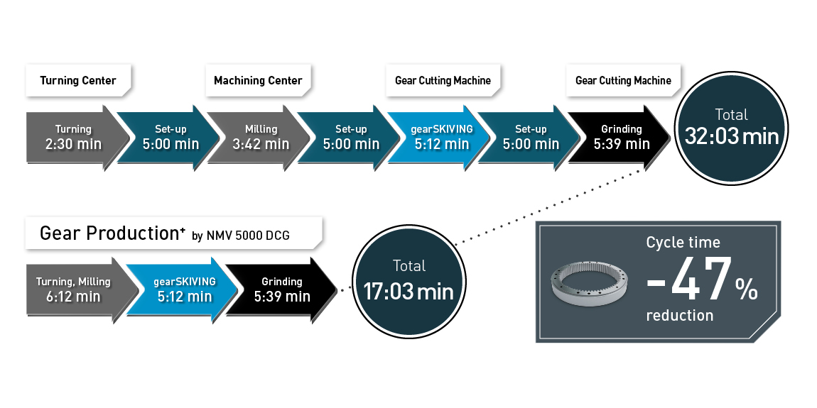

47% reduced machining time due to process integration
  • Internal spur gear: Outer diameter Ø210 mm // inner diameter Ø210 mm
  • Face width: 30 mm // 6x tapholes M10
  • Module 3
  • 55 teeth
  • Material FCD400
