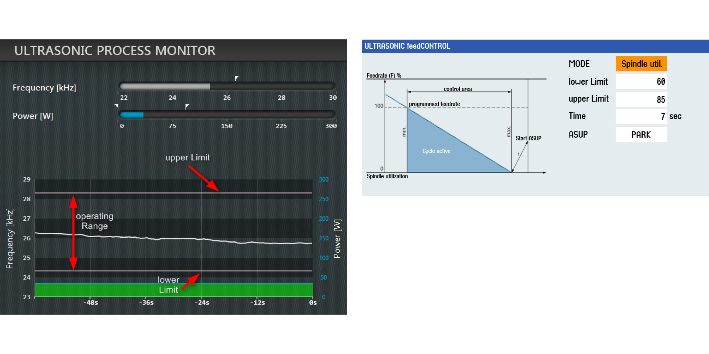

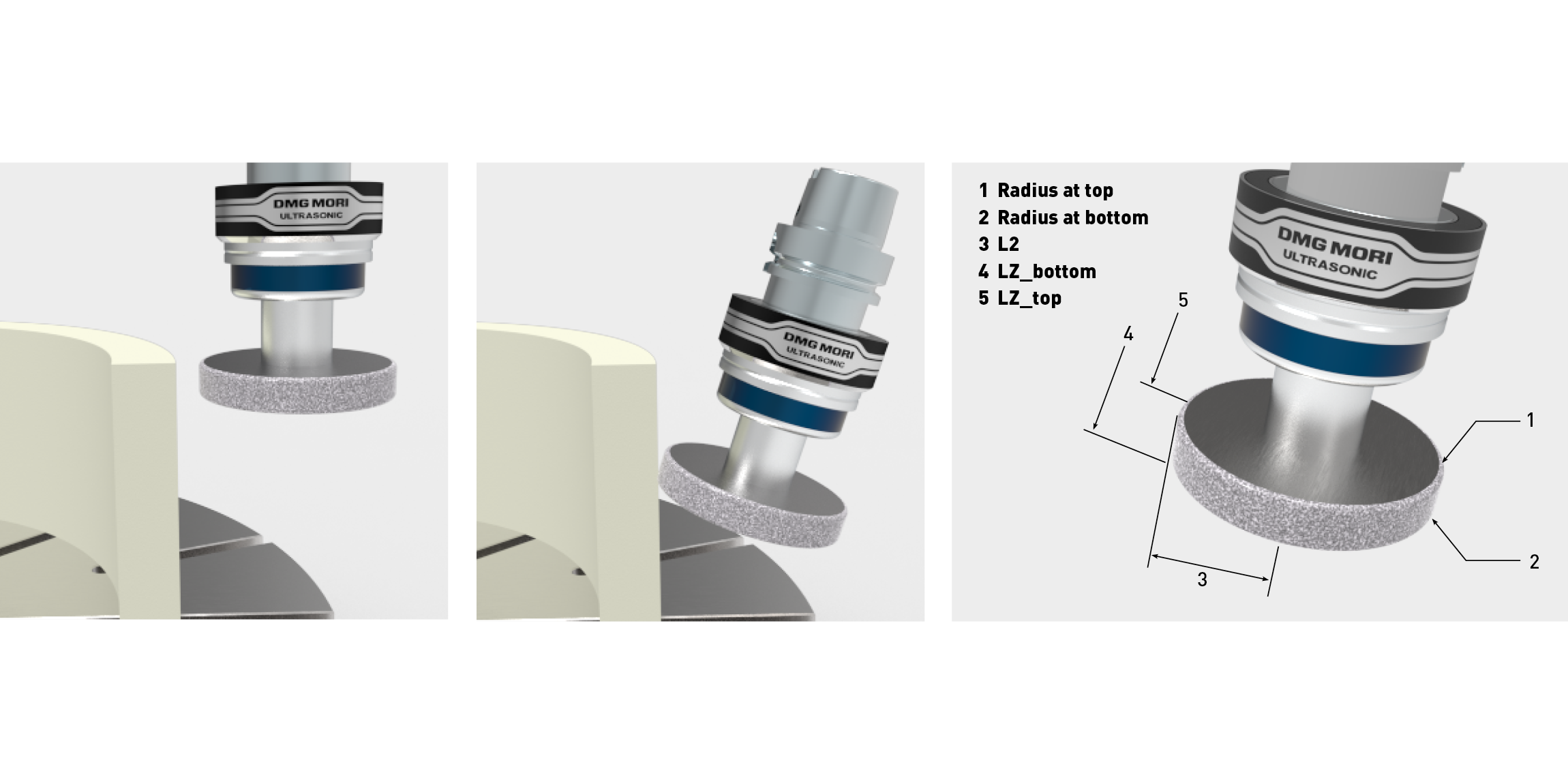

  • Technology integration via HSK-E32 interface for ultrasonic superimposition of tool rotation with amplitudes of up to 15 µm
  • Process forces reduced by up to 50% thanks to ULTRASONIC: higher feed rates, improved surface finishes down to Ra < 0.1 µm, longer tool service life depending on requirements
  • Stable process window during machining for maximum reproducibility and consistent machining results.
  • Ensuring the ULTRASONIC advantages even with non-optimal tools.
