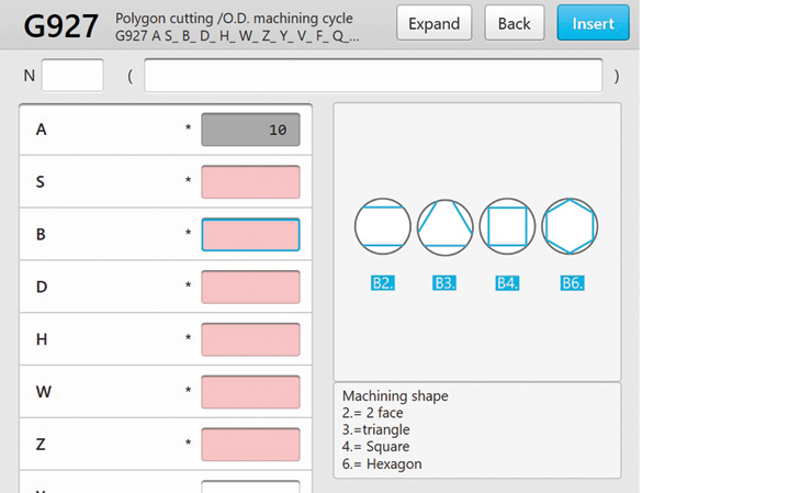

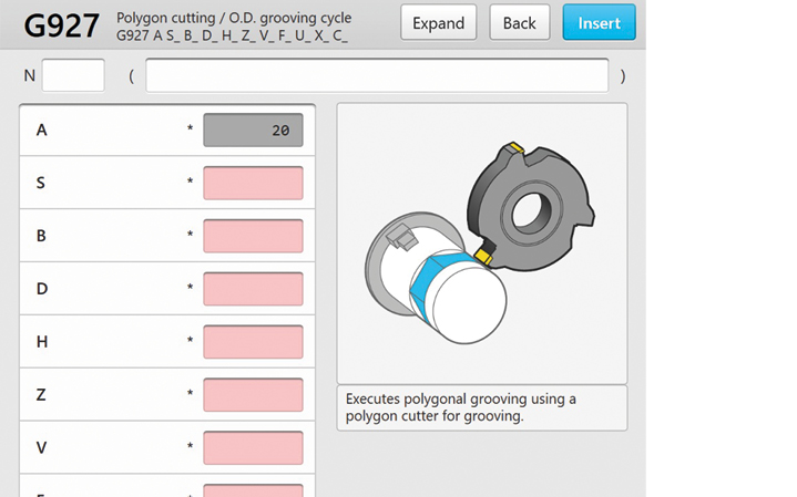

Control & software
- Integrated safety function checks the plausibility of parameter entries

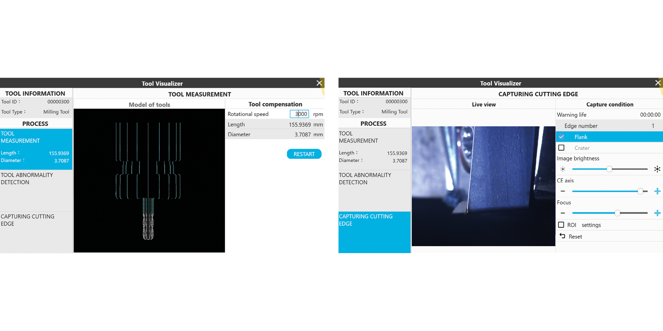

- Non-contact measurement with the integrated and protected camera system
- Automatic measurement of the tools
- Support for fine correction of tool dimensions
- 3D visualization of the measured tools
- Detection of tool abrasion
- Time saving due to the fully integrated measuring system
- Automatic tool correction possible through offset data
- High-resolution camera image for detection of tool damage and abrasion without having to remove the tool
