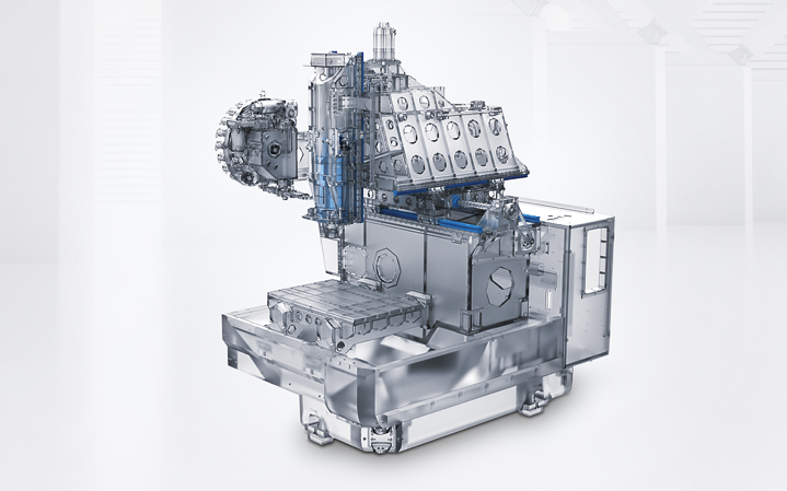

Powerful 3-axes machining
  • Rigid design with fixed table and elvated X-slide
  • Perfect automation capability with large automation door at the side (30.9 x 42.2 in)
  • Optimal crane loading based on large opening of cabin roof (61.41 in)
Tool magazine
  • Basic version with disk type magazine, 20 pockets and double gripper
  • Magazines SK40, SK50, HSK A63 and HSK 100 with 20, 30, 40*, 60 or 120 pockets optionally available (*nur SK50 / HSK A100)
  • Main time parallel loading and accessibility from the front
Spindles
  • speedMASTER spindle with 20,000 rpm in basic version
  • High-Torque spindles with 15,000 rpm and 29,5 Nm (option)
  • Motorspindle SK50/ HSK-A100 with 10,000 rpm and 303 Nm (option)
  • Rigid design with large fixed table
  • Innovative cooling of guideways
  • Innovative cooling of ball screw nuts
  • Direct path measuring systems included in the basic machine
