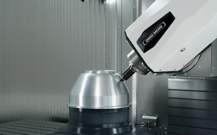

DMG MORI DMF 200|8 – Innovative concept in the travelling column series
DMF 200|8 Teaser
DMF 200|8 Hybrid
Maximum Flexibility
  • Modular platform concept is the right solution for every request
  • 4-axes machining with B-axes and 5-axis with rotary table (optional)
  • Mill-Turn Technology for highly complex geometrics on one machine (optional)
Constant rigidity enables a high chip volume and a maximum productivity
  • New basic construction with constant overhang in the complete working area
  • 3 linear guide ways in X-axis and single piece machine bed made of cast iron
  • Spindles from 15,000 to 20,000 rpm and up to 200 Nm
High accuracy and best surface quality of the machined workpieces
  • High thermal stability based on expensive cooling measures
  • Direct drives in Y- and Z-axis
  • Dynamic package with linear drive in X-axis (optional) and higher acceleration and feed rate in X,Y,Z-axis
Maximum productivity for your shopfloor
  • Collision free tool change outside of the working area
  • Tool magazine with up to 120 pockets and a tool length of up to 400 mm
  • High variety of machine table options - perfect for all requirements
  • Reduction of down time based on the partition wall (optional)
  • Increase of productivity based on DMG MORI Technology Cycles, e.g. angularTOOL
