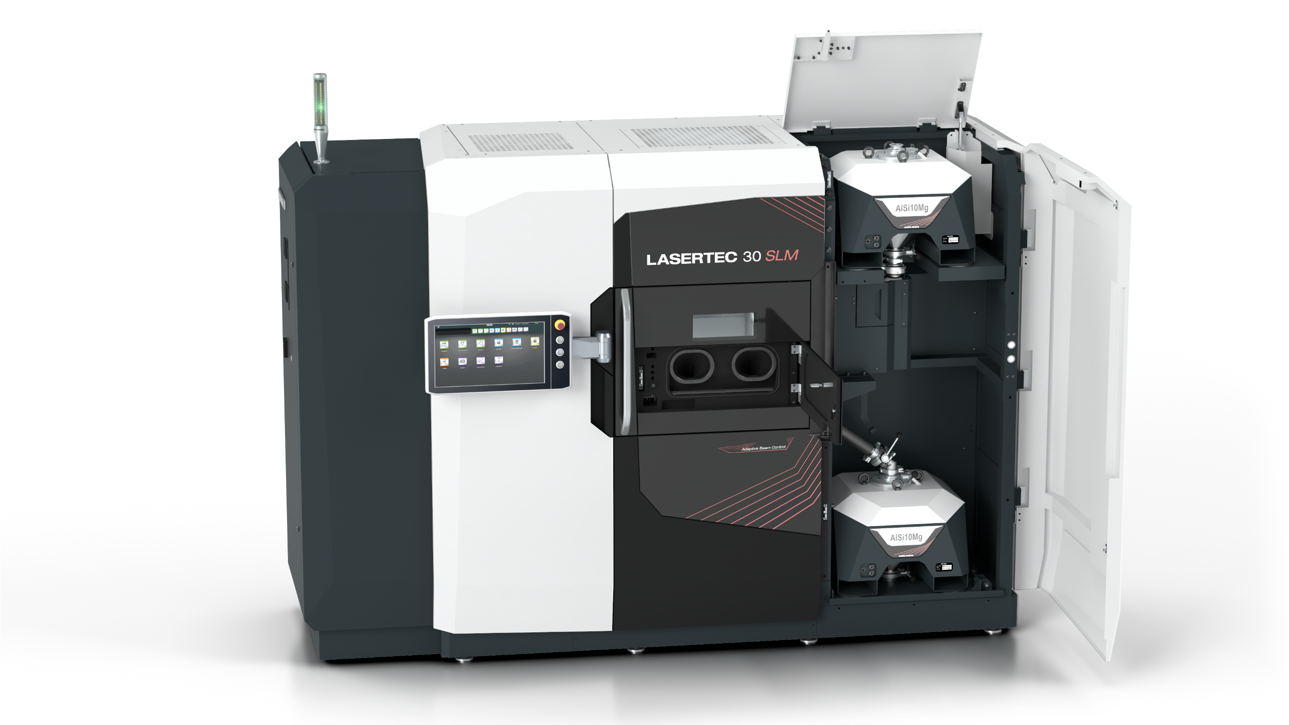

Elegant design with a focus on functionality
  • Single footprint - makes factory floor layout easy with integrated chiller and filter
  • Streamlined setup - only connections for power, inert gas and compressed air are required
  • Flexible Lifting: Overhead or with fork lifting devices

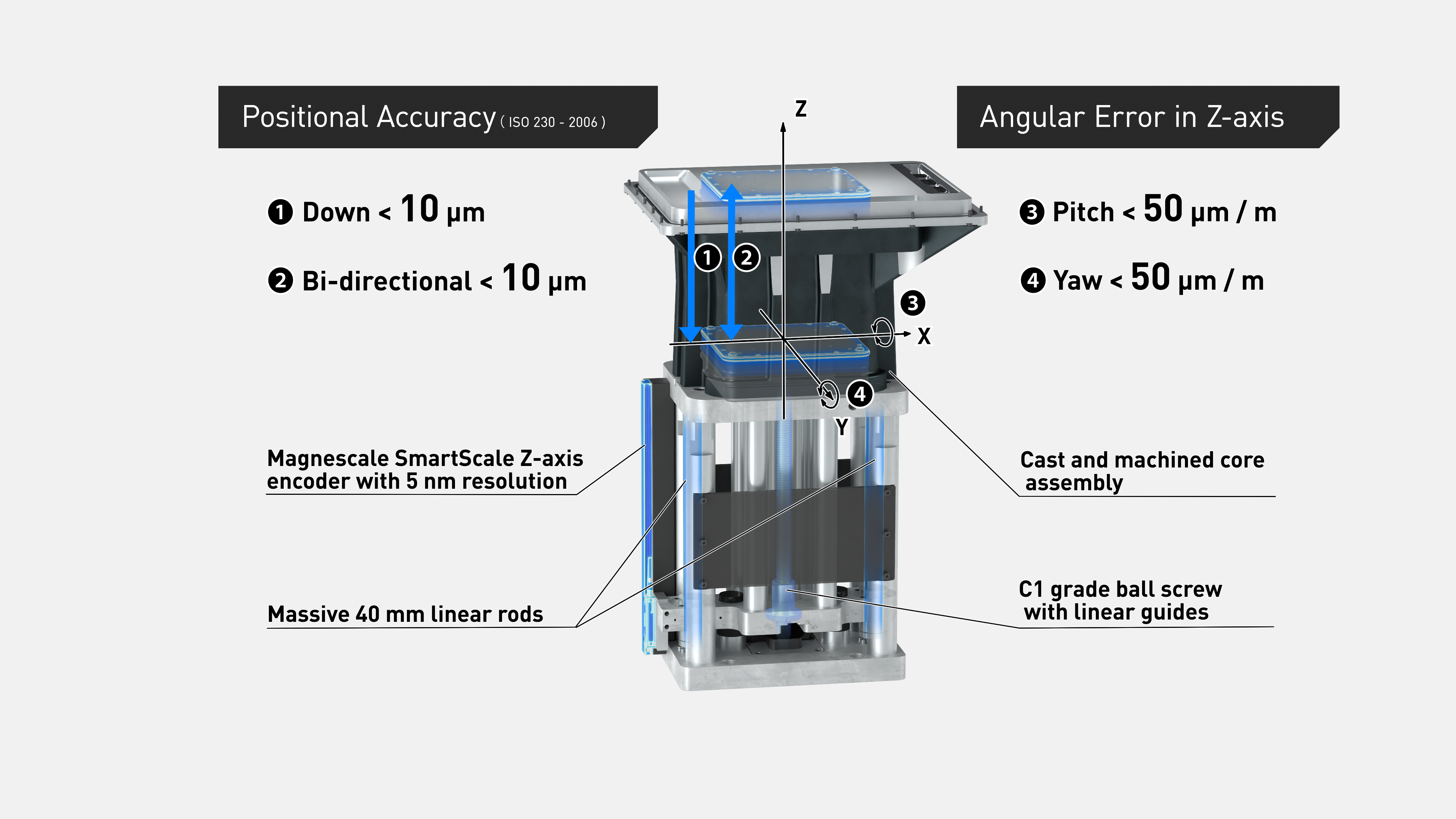

Best in class accuracy
  • Magnescale SmartScale Z-axis encoder with 5 nm resolution
  • 2-piece cast and machined core assembly
  • C1 grade ball screw with linear guides

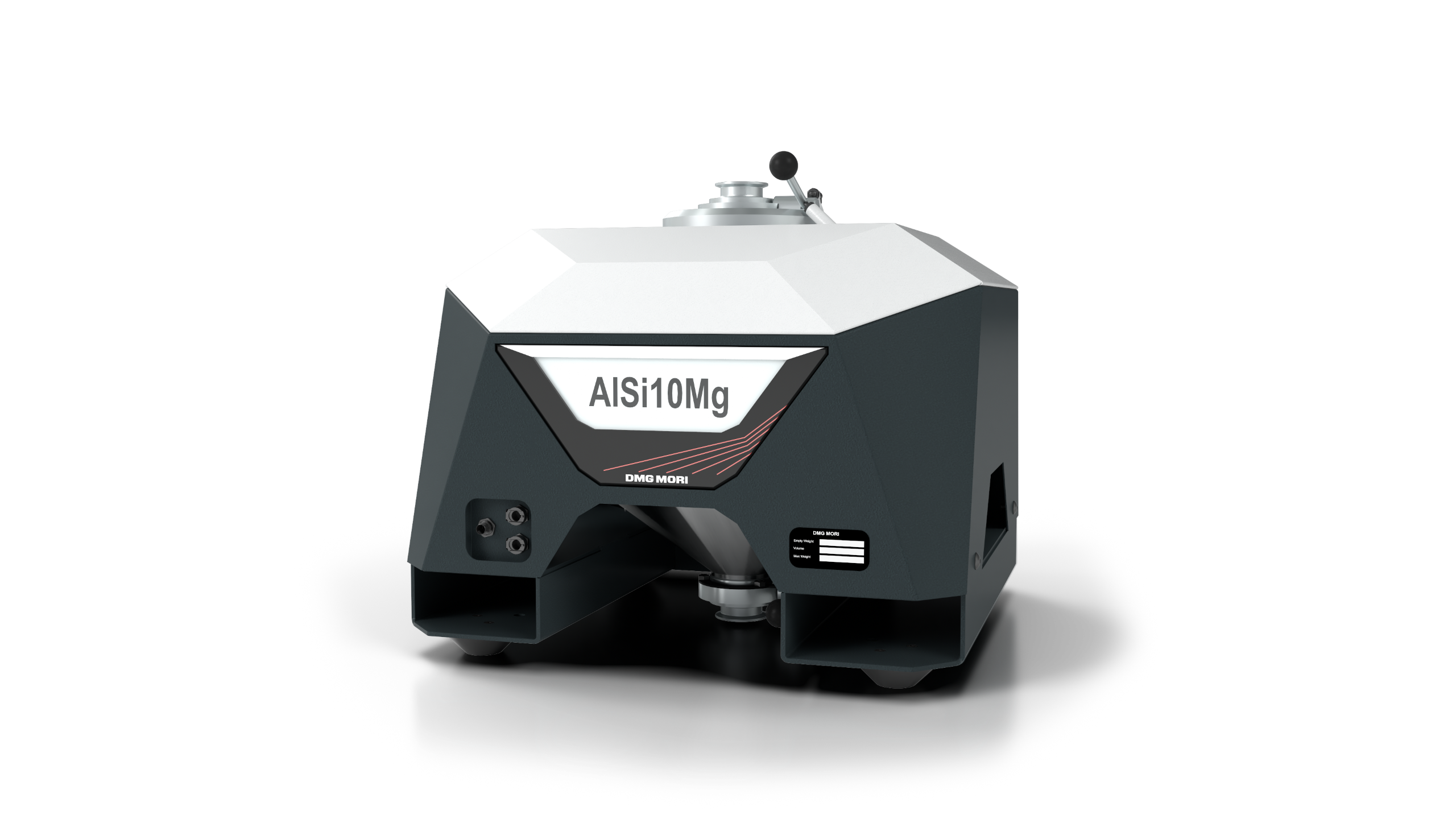

Large powder capacity contributes to a more efficient, productive and cost-effective metal 3d printing process
  • 48-liter tank capacity - ensures full height builds
  • Dual valves support sealed storage and mid-job tank swaps
  • Self-locating feet makes tank insertion/removal easy
