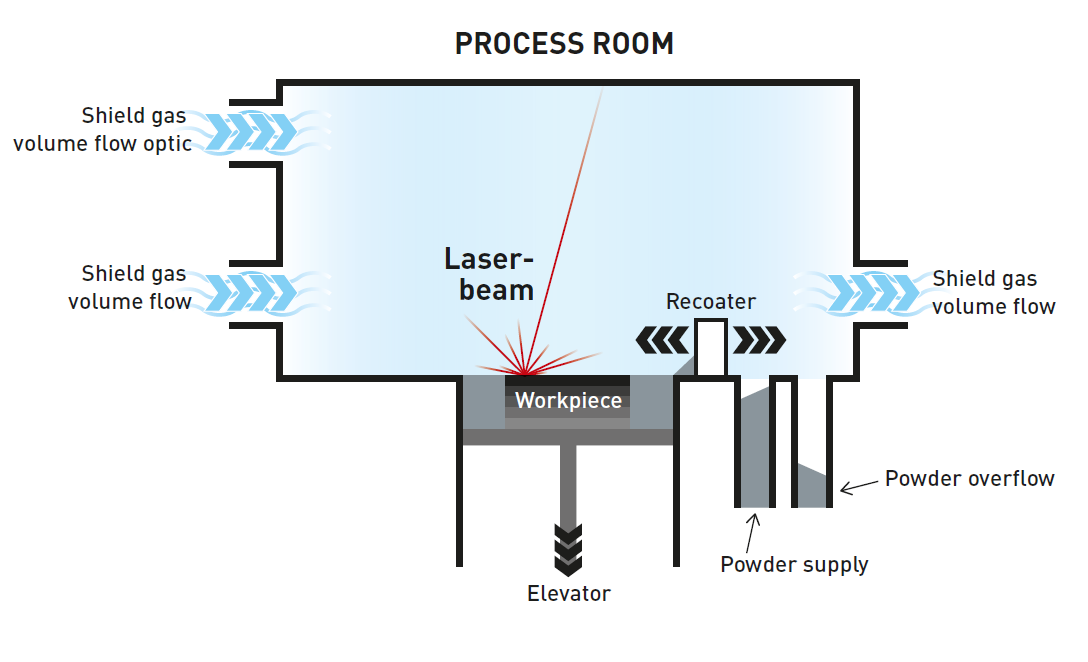

Additive Manufacturing with a 125 x 125 x 200 mm (X / Y / Z) building volume
  • High precision building of 3D parts with a focus diameter of only 35 µm
  • Application-specific fibre laser sources from 200 W as standard to 400 W optional
  • Optimised shield gas volume flow for highest component quality with minimum Argon consumption
